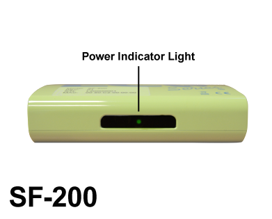

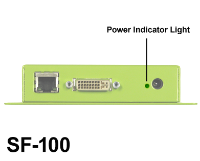

Both the SF-100 and SF-200 have power indicator lights. For the SF-100, you should see a solid green light next to the power port. With the SF-200, the green light is located on the front of the play er beside the IR sensor. If these lights are on, the player is receiving power correctly. If a red light is displaying on the SF-200, this indicates a power issue. The next step would be to cycle power (See Rebooting the Player below). If the light is not on, ensure the power supply is plugged in completely to the player and the power source. Confirm the power source, such as a power strip, outlet, and breaker (if applicable) are turned on. If the power indicator light is still not on, is blinking, or is red, this is most likely a failed power supply. It will need to be replaced with the appropriate power supply.

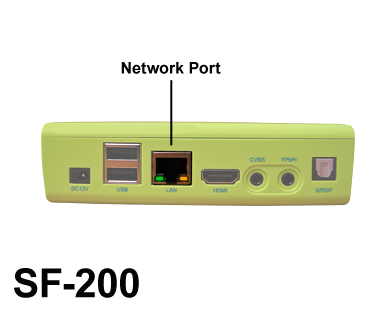

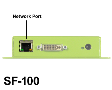

Network Connection
If the player is not connecting to your Suite after typing in the correct Noventri Server address and port, check the following:
- The network port on the player for blinking lights (usually amber/green)
- If no lights are blinking, make sure the network cable is plugged in securely into the player and the wall jack's network port
- If there is still no network activity, connect another device to the wall jack's network port (such as a laptop or network tester) to verify you have network/internet access

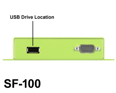

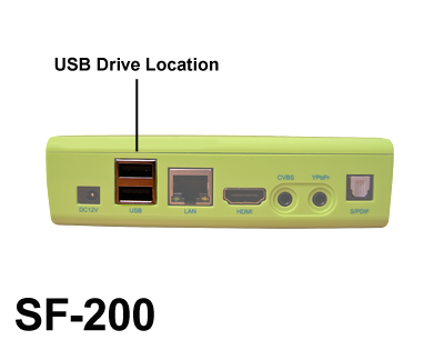

USB Drive
Check the USB drive to make sure it is fully seated into the player:
- Turn off power to the player
- Remove the USB drive from the player and reinsert the USB drive back in
- Restore power back to the player
- Power off the player
- Remove the USB drive and insert it into a computer
- Right-click the USB drive letter in My Computer and select Format
- Leave the default settings and click Start
- If the format completes successfully, safely remove the USB drive by right-clicking the USB drive letter and selecting Eject
- Reinsert it back into your player
- Restore power to the player
