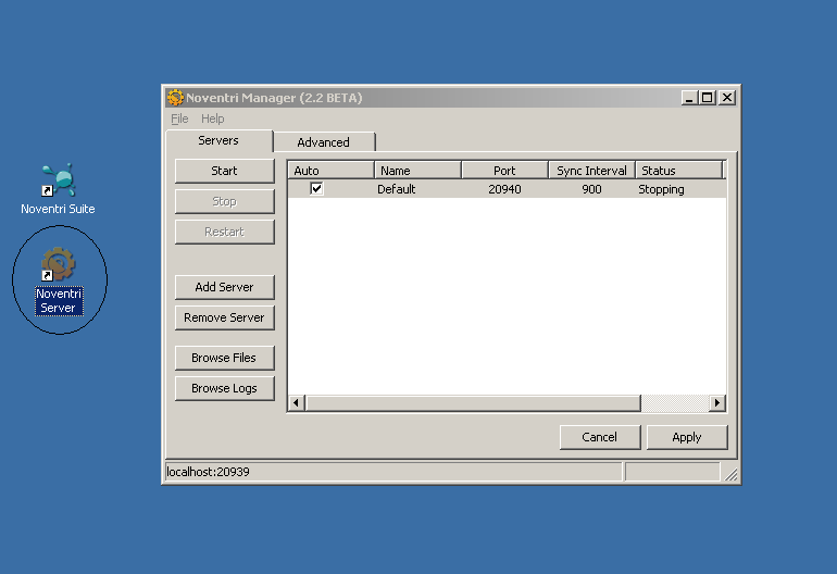

Once connected, you will be presented with the Noventri Manager Dialog. Refer to the following photo of the program in action.

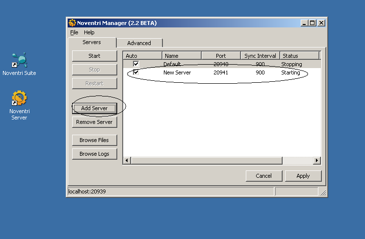

In the above picture, the “Gear” icon on the desktop will launch the Noventri Server Manager. Notice that the default server is already created for you, with the default port number of 20940. If an additional server is desired, then simply click the “Add Server” button, and the new server will appear automatically. Notice now that the port number has automatically been incremented to the next numerical value.
In the above photo, we can also see that the check box is automatically set to start the new server instance. This will ensure that this server will automatically restart if any system reboot, or crash occurs. The end result is that the customers content is safe even if there is a problem on the physical machine.

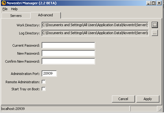

As shown in the following photo, If you desire to change any of the Service Manager login information, you may do so in the Advanced tab of this program. If anyone wishes to change the location of the logs or their work directory, click the [...] button to make the necessary changes.

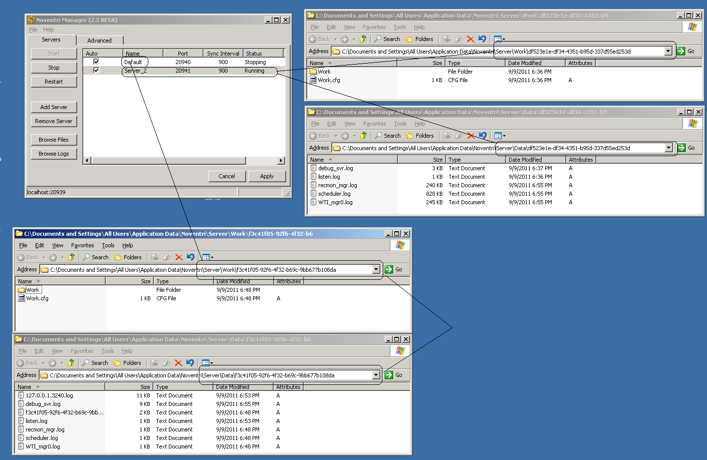

Now, in the next photo, we would like to address the issue of Log and Work directories. The Work directory contains all of the server instances created within. The Default server work and log directories point to a “Separate” sub-folder than the other Server_2 instance. This effectively keeps only the specific server content that corresponds to itself in that particular sub-folder. Any Clients that are logged on to a server will never see or have access to another customer’s material. To explore the differences I encourage you to highlight the server that you wish to query, and use the “Browse Files” / “Browse Logs” buttons to examine the information contained in each folder.
