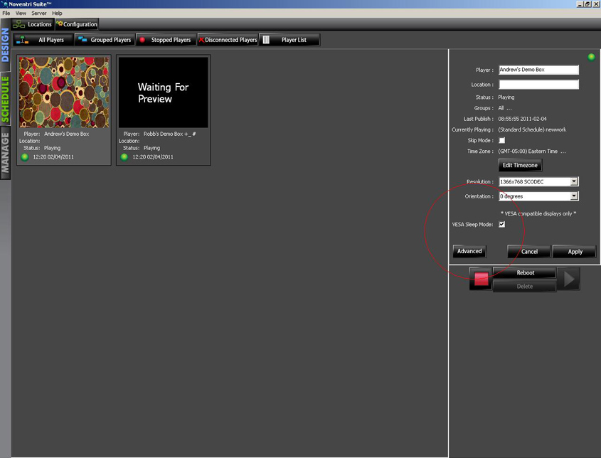

The LG M4214C has been tested to work fine. Please be sure that your VESA Sleep check box is checked. To do that, go to the Manage tab and click on the player of concern. You'll see the check box in the player options. I'm including an image for reference.
Please let me know if this fixes your problem.
